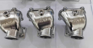

Here's a link to the manifold you'll need if you want to turbo a C2. They also offer a tuner standalone ECU but you do have other options.
