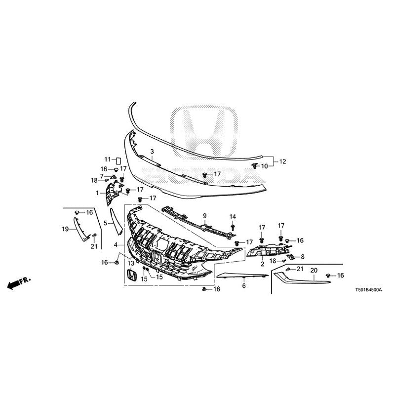

I want to install the e:HEV Honda grille badge on my Hybrid ST and I was wondering if it would be compatible on my car. I imagine that it would be, but I would love some clarification!
Shown below.

Thanks, what’s the installation process like?
#4 ·
Thank
The "official" way is to remove the front bumper to have access to the push nuts holding on the emblem. The unofficial and faster way is to use a trim tool to get fishing line or floss behind the emblem, without removing the front bumper.
In the case of the latter, the pins on the emblem may be left behind. Though that can quickly be solved using strong 3M molding tape. You'll just have to cut off the pins on the new emblem.
Here's a helpful YouTube video showcasing the unofficial method.
And, if you prefer Honda's way, the installation instructions for the emblems are attached.
